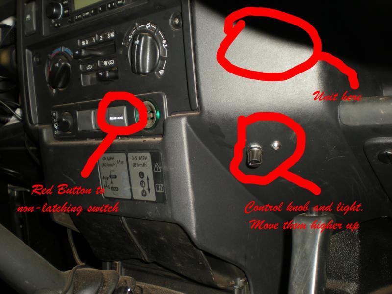

    Jake MLR did a very good job of fitting the Redarc with remote switches into my Puma (It was taken out of my D2a).
    Pic from previous thread:

    My car is with the Auto elec. They have managed to locate my prodigy in the little slot under the dash on the right side near the door part of the casing that houses the steering column has been carefully cut away and the Prodigy fits like it was meant be there.
