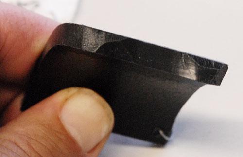

Anyway, I cut a piece out of the genuine safari snorkel and it looked like this below.
Nothing startling. A smooth cut surface with no grabbing on the fine blade.
Did the same with the ironman copy snorkel and here's the first warning sign.
The cut is rough, feathers and edges visibly lighter colour. That tells me straight away that the plastic is different to the genuine product.

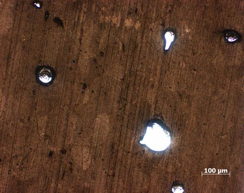

Back to the genuine safari product and a very thin slice and under the microscope.
This shows a homogeneous structure (with voids).

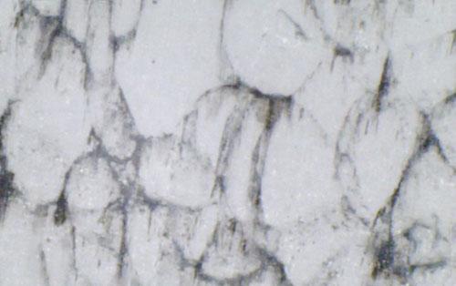

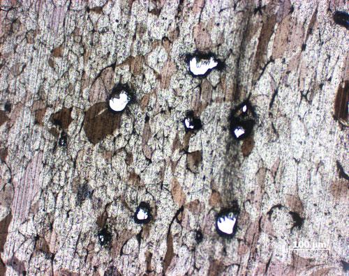

Now the copy snorkel.
Right away I could see a grainy structure. A further close up shows the plastic grains even better.
So what we have is a copy snorkel that is made up of whatever that white polymer is (I can't test it here) with the carbon black colouring agent coating each grain.
This means that the structure itself is only as strong as the grain and will become brittle at low temperatures.

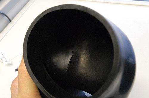

I also had a look at one of the copy rubber hoses and thought wow, that's a pretty good copy. I'd have trouble telling it from the genuine article. I then gave it a bit of a squeeze and looked inside at the huge crack along the moulding part line....
