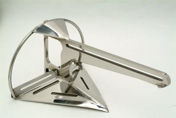

    I've always thought that a sea-anchor would be a good option
    Adelaide Hills - SA
    12,486
    Yeah - found the thread: Winch Recovery - No Trees
    This is the sea anchor I was thinking of: Super SARCA Anchor - anchorright.com.au
