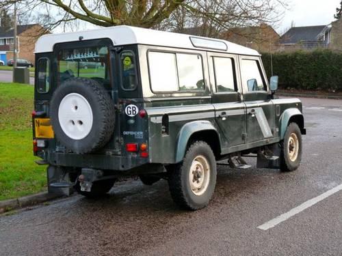

    A) What model Deefer?
    110 Cab chassis - Easy to get; but not much cab length.
    110 Wagon - Easy to get; but harder to convert to something usable
    110 Hard top - Hard to find; but much easier to convert
    110 Ute back - Perfect!; but where do I find one???
    90 Hard top - Hard to get; not sure about directional stability at speed?
    90 Ute - Impossible to find in AU? Directional stability?

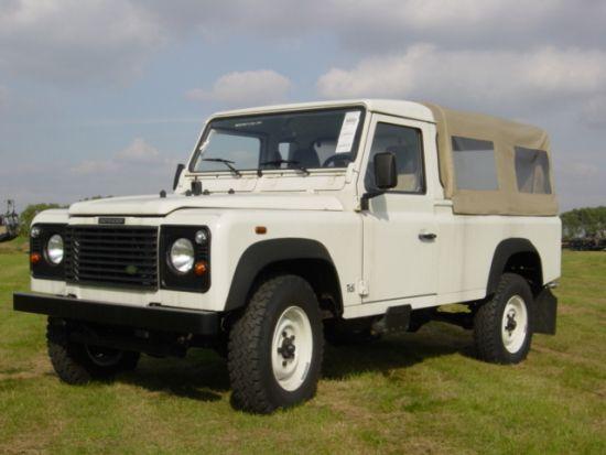

    I'd like the finished product to look something like this:
    from here: Barker Land Rover Racing
    The biggest challenge is finding a written off vehicle in the right condition to start with....

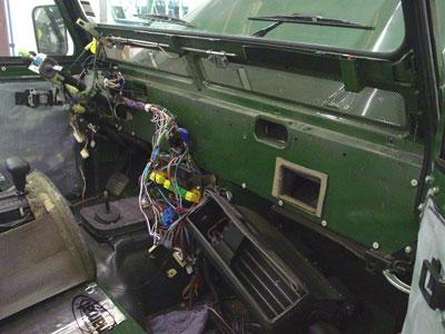

    Cab
    Defender Single cab unit
    Everything stripped out including all glass - I like the way the firewall is when stripped out
    CAMS approved cage design
    Back wall of cab removed for extra race seat length and rollcage?

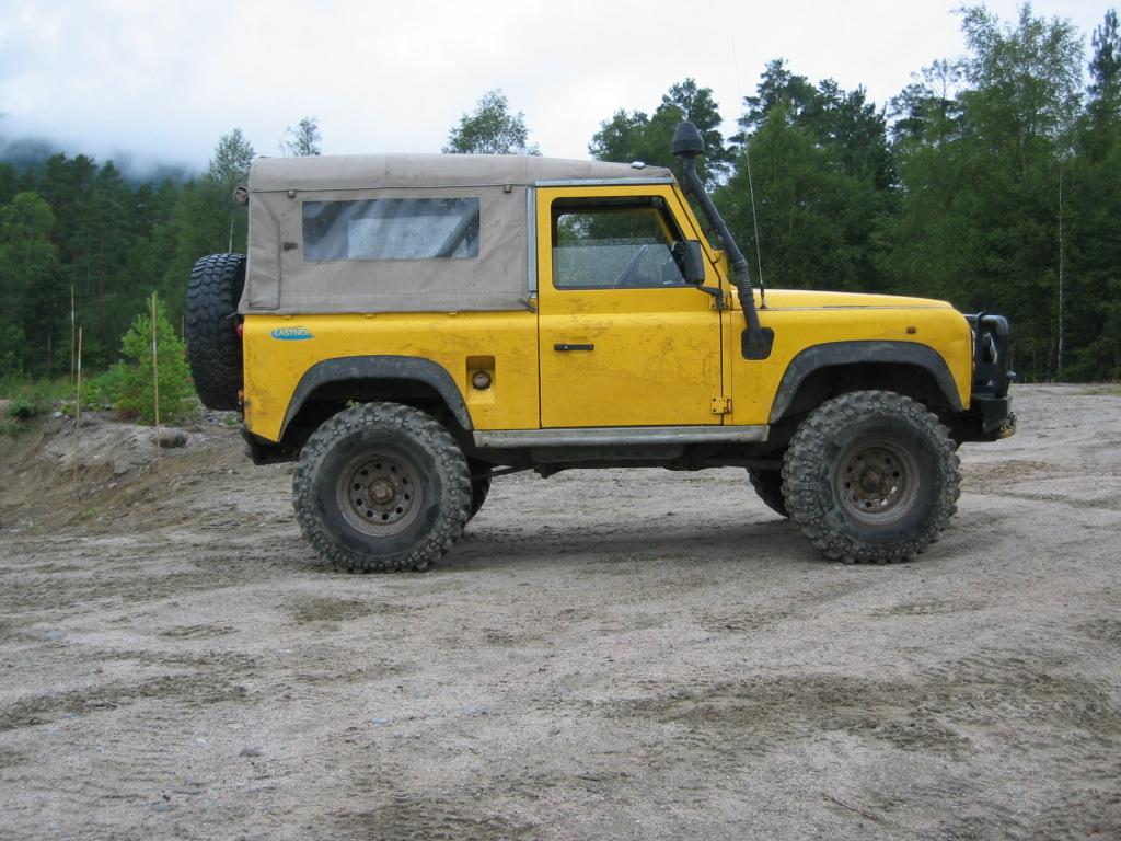

    I'm trying to visualise the finished shape as being something like this?
    So who wants to correct the mistakes in my thinking?
