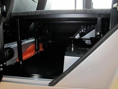

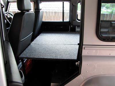

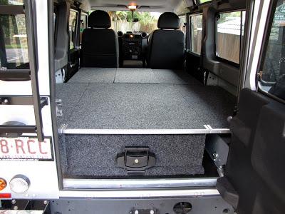

    We have gone with the alternative, a 5 door where we take out the rear seats as required. We installed a drawer in the rear area to level up the wheel arches, then I made up a simple steel frame topped with ply covered in marine carpet to level off the seat area when we remove the seats.
    It is trivial to remove the rear seats when required, and because we have the 5 door there is the added advantage of having access to the space under the frame through the rear doors.
