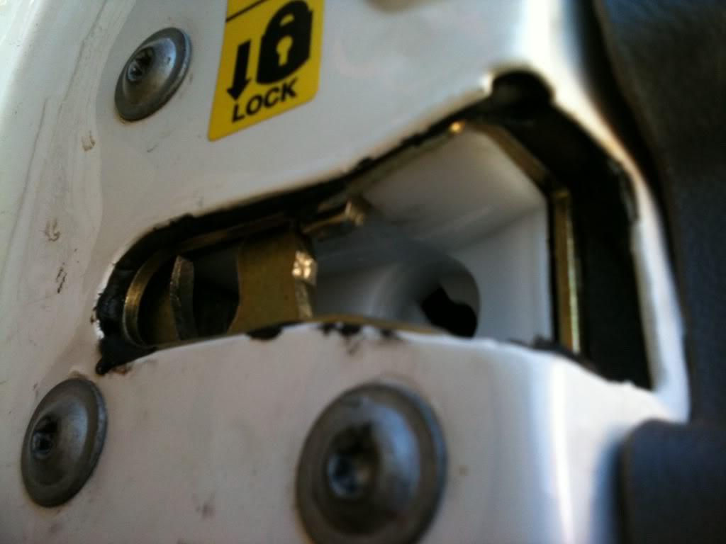

    Hi All
    my rear door has locked and wont unlock and i need to get in there and have a look around and spray some silicon around
    can i get the inside trim off with the door closed?
    Is the window winder remover the standered type tool to remove the winder ?
    thanks in advance

    when i say rear door i meant the rear passenger door
    not the back door to the wagon
    just to clear that up
    thanks

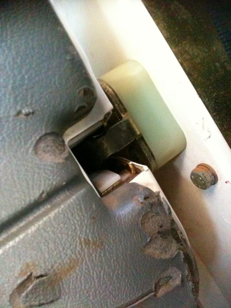

    opening up locked rear door
    G'day scottygc,
    I recently replaced the nearside rear door lock ( although with benefit of having an open door because the bugger wouldn't lock!).
    You would have to remove the rear seats as after whipping out the window handle, door handle, lock surround and door latch, the trim panel needs to come inboard as you ease out the 'fir tree' plastic plugs (I don't believe you would have the room to work or remove the panel if seats stayed in situ). Plus the front seat belt winder may be a pain....
    Other than that fiddly process, having just poked a look at the Deefer 130, have you tried tripping the spring loaded locking latch from the inside? Given LR's 'generous' body tolerances of the Deefer, you might be able to get a thin screwdriver or fencing wire above the door frame locking post and unlock the sear.
