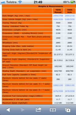

    Why does everyone keep saying this???
    Fully fueled, all fluids and top spec is only 2700...
    SE spec TDV6 Auto is a little over 2500kg...
    My D2 weighs more than Peters D3 with Winchbar etc...
