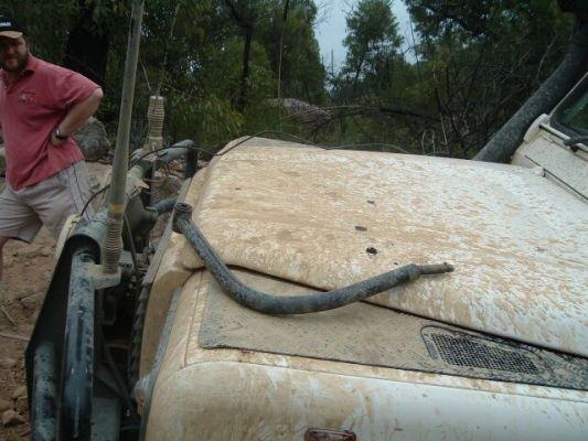

The links may be fine, but as said the bend still makes them weaker. You cant defy physics. What is typed is also marketting. The material and manufacture process is nice to know and those aspects are FIA approved, but it doesn't tell you anything about the strength. An $800 JD2 bender will bend that material easily and repeatably all day and all night etc.
This is what the bends induce, and yes this was a HD unbreakable one.
