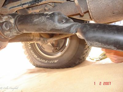

					Yep, 2" (maybe a bit more?) lift killed my front prop, the already slightly worn UJ didn't like the operating angle.  I was doing about 90km/h on a country road at the time; had fun hammering the floor straight again...
 Now I listen for squeaking, grease fanatically and have dropped the car back to normal height.
