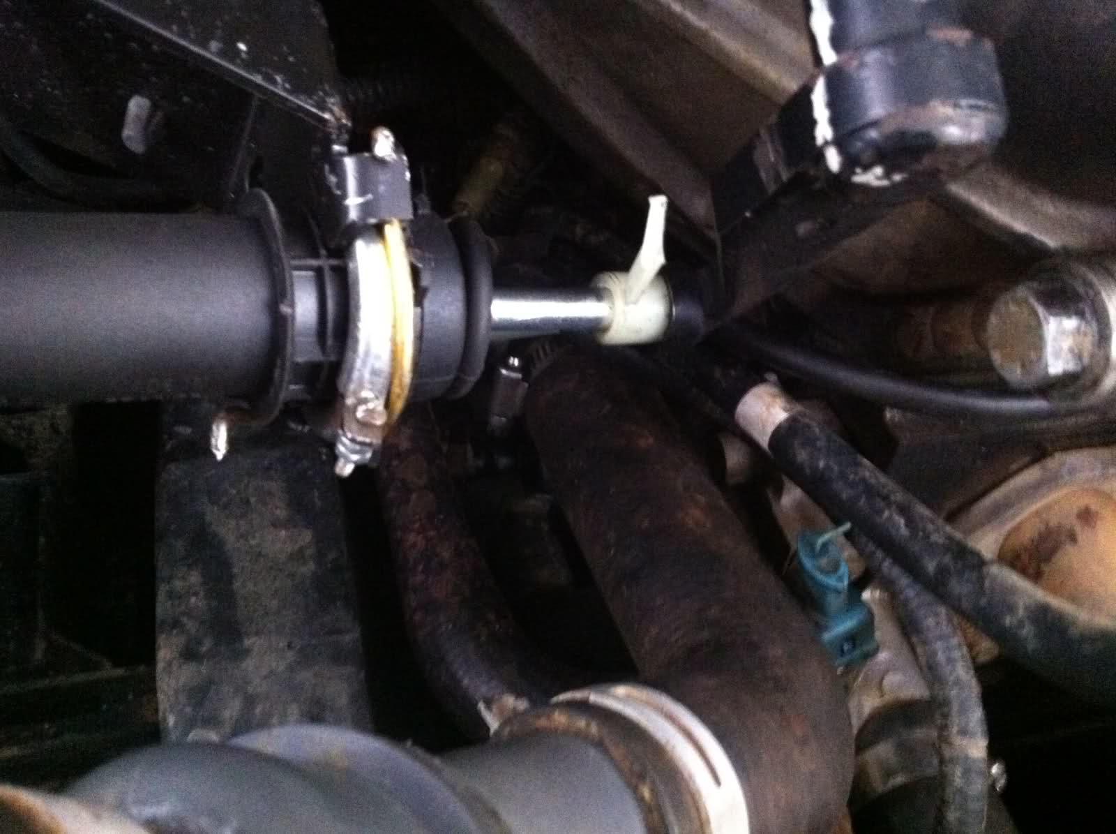

its not disengaging properly...
could be friction plate in the wrong way
could be a damaged friction or pressure plate, even a warp on the flywheel.
could be the clutch is not bled properly.
could be the clutch pedal is not adjusted or getting full travel.
