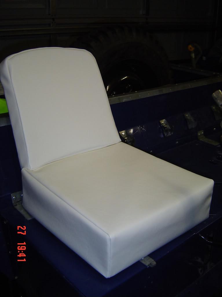

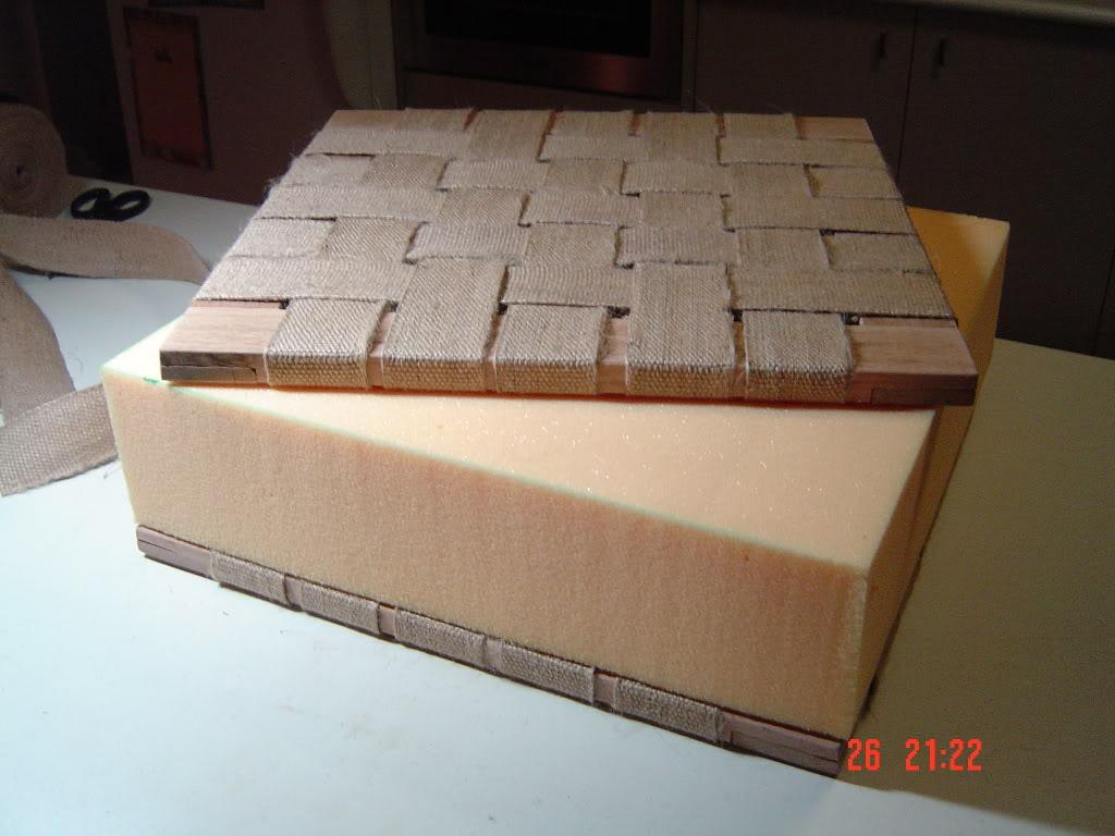

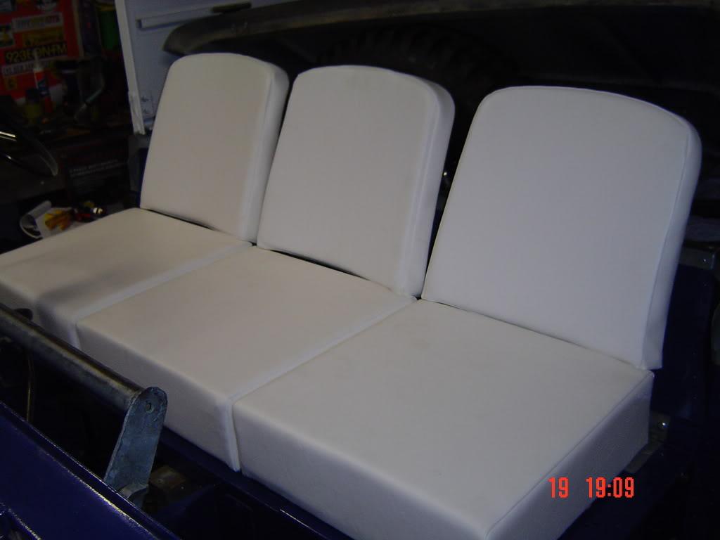

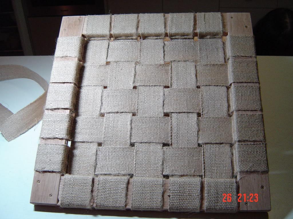

    Steve,
    I have a 1951 and made my own bases as seen in the photos, they are probably not good enough for the rivet counters but work very well and are generally comfortable.
    On the Bases, I used Timber (Mountain Ash/Tasmanian Oak) 50mm wide and 19mm Thick. The Bases overall dimension is 430mm X 430mm (17" X 17")
    On the base I used 100mm Thick Medium Density Foam. and 40mm Thick Low density foam on the Backs.
    The wife sew up the material, (I know its white, and believe it or not it is easy to keep clean)
    I can take a photo of the underside if that helps.
    Wal

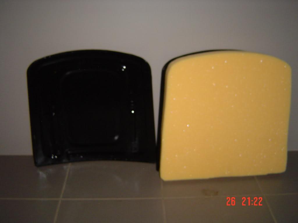

    Well after lots of research and a few wet and windy nights, I finally got sissors to fabric.
    The base is 17''x17'' same as Wal's but with some plywood sheet to put the foam on. The foam is high density 5'' thick, cut 17''x18'' to allow for the shaped front edge and tapered from 5'' front to 3'' rear. the seat backs have 1'' foam for padding.
    The vinyl is from Spotlight and colour is Forest green, from a sample under the hinge on the seat back.
    The piping around the edge is vinyl wrapped around a piping cord and sewn in with the rest, tricky to get the corners right.
    As you can see they are in test mode and seem to be comfortable enough,but abit of work to finish off the bottoms yet.
    Now all I need is the landy to but them in.
