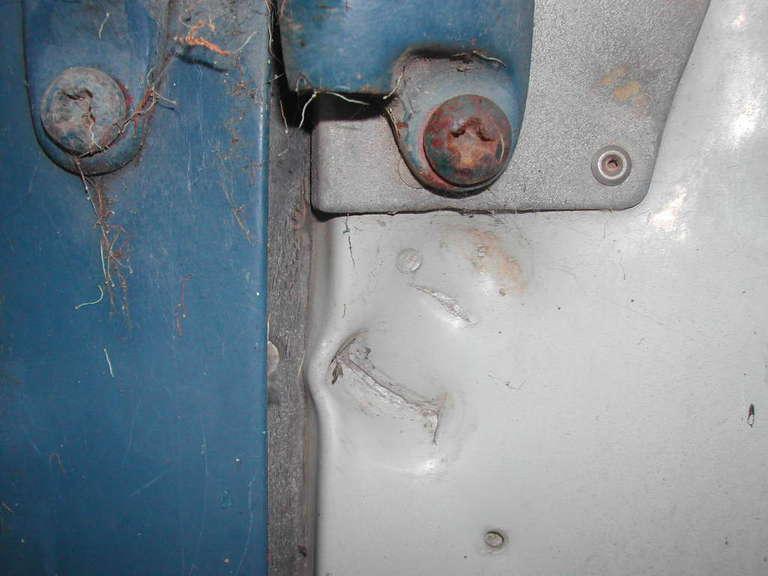

    Will upload a couple of pics of my Son's Stage 1 that was hit by a flying shackle at over 100metres and his car wasn't involved in the debogging.
    BTW the dent is from the shackle pin, the body of the shackle went through the back window of the tow vehicle and out through the front windscreen, no one hurt(4.7T SWL rated shackle, brand new).
