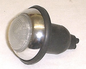

    G'day there guys, new to all this, but I have a 1952 80in in original and complete condition, so much so that I am about to put it thru rego,
    however the one thing missing and I can't find anywhere is the front parking/clearance lamps on the guards, as opposed to the the ones below the windscreen on earlier models. They appear to be glass, with a chrome surround that slips into a rubber boot, I can put later model plastic ones on but I'd like to try and keep it original, any ideas on where I can track some of these lights down is greatly appreciated.

    Lucas 489 https://www.vintagecarparts.co.uk/pr...l-lucas-l489-1 a little bit pricey although you may find them on ebay. They were also fitted to Morris Minor and some 1950s Wolseley.
    Also at Holdens http://www.holden.co.uk/displayproduct.asp'sg=1&pgCode=010&sgName=Electric al&pgName=Lighting&agCode=0050&agName=Side+Lamps&p Code=L489/52139
    There are a pair of NOS lens and chrome surround on ebay http://www.ebay.com.au/itm/NOS-LUCAS...item3cbd4a6062
    You can then use the Lucas 575008 bulb holder 576105 rubber boot or you can look for L594 body which is far more common and available cheaper then fit the L489 lens etc.

    The 501B are the correct "D" Lamps for the 80" in Australia, the 503 style was a UK spec thing for later 80" and 86" when the UK authorities specified a minimum area of red for the tail lamp, for which the "D" lamp with bar was too small.
    The L488 lamps are frequently used in place of the L489 on S1 (and SII) because of their easier and cheaper availability but are incorrect to the rivet counters (IIRC 468 rivets) The bodies and rubber boots are interchangeable.
