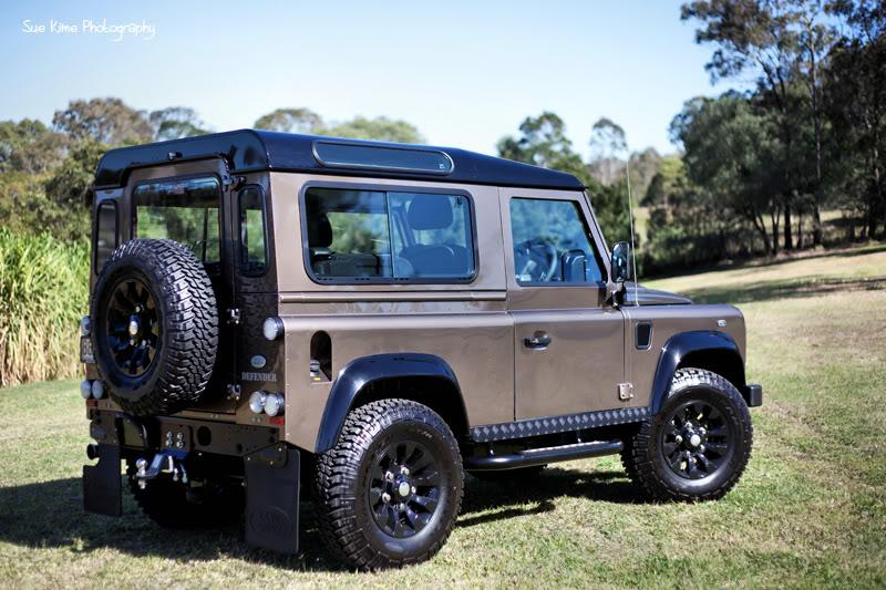

I've got Good Year Wrangler Muddy's on mine.. and have found them great.. road noise is a tiny bit high but not enough to bug me..
I have been stopped a couple of times by other Defender drivers asking what tyres they are as they liked the look..
Nice Sue. Very nice.
