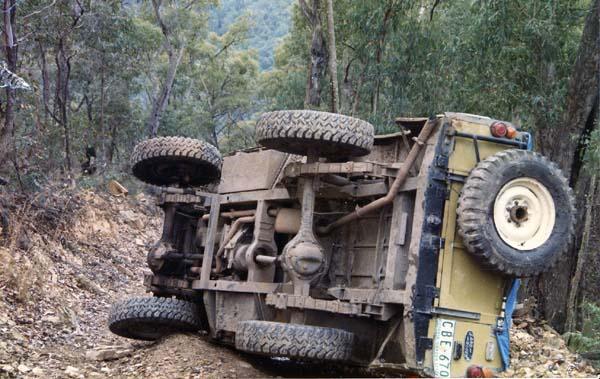

    Heres one I prepared earlier
    Early 3.7 LandCruiser Front & Rear end , this one has a P76 eng RRC Gbox/TC.
    Aawe, that's cute.
    Did it take you long to train it to roll over for a belly tickle?
    Adelaide - Torrens Park
    7,291
    I have most of the bits stored to do that to my IIA 109. Toyota axles, Rangie gearbox, spare 3.9 engine (still in my RRC, but will be coming out). I hope to not park it like that once I am done though!
