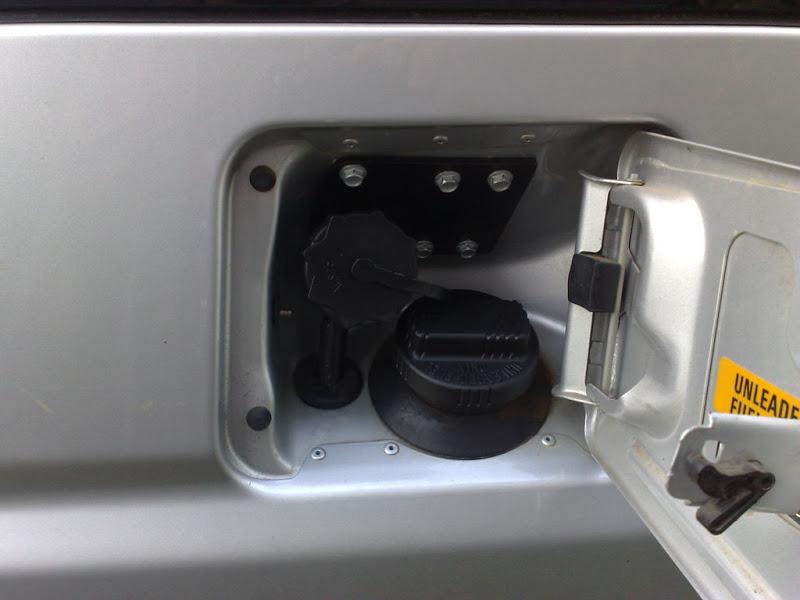

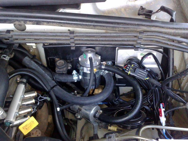

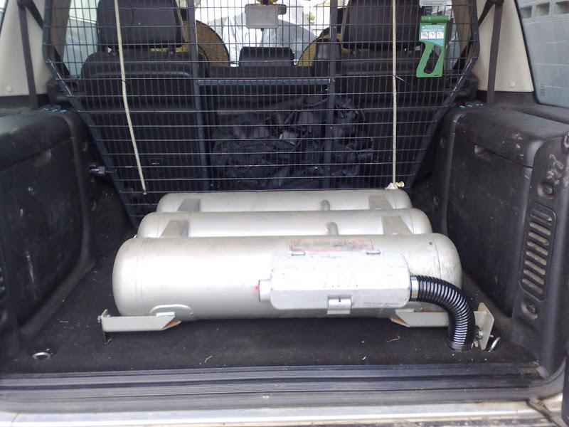

    It depends a lot on the tanks & location you choose as well as the under bonnet kit.
    Here's what I did:
    Bought a Marrelli under bonnet kit from the UK Approx $1100 delivered.
    Had my installer source a second hand manifold tank & install the lot for $2700.
    After the $1500 rebate (which is now $1000 I think) it cost me $2300.
    Best money spent so far
