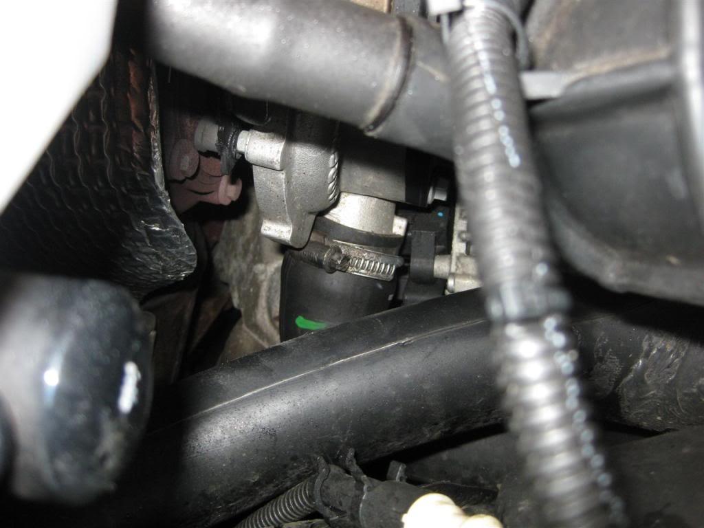

					It is common on earlier Pumas too. Found this after a routine check of the engine bay.
 The jubilee clip was loose enough for me to move the hose up and down on the flange. Once repositioned and tightened it has not moved.
 I will be replacing the OEM hoses with Samco XDB Boost Hoses once I am out of warranty.
