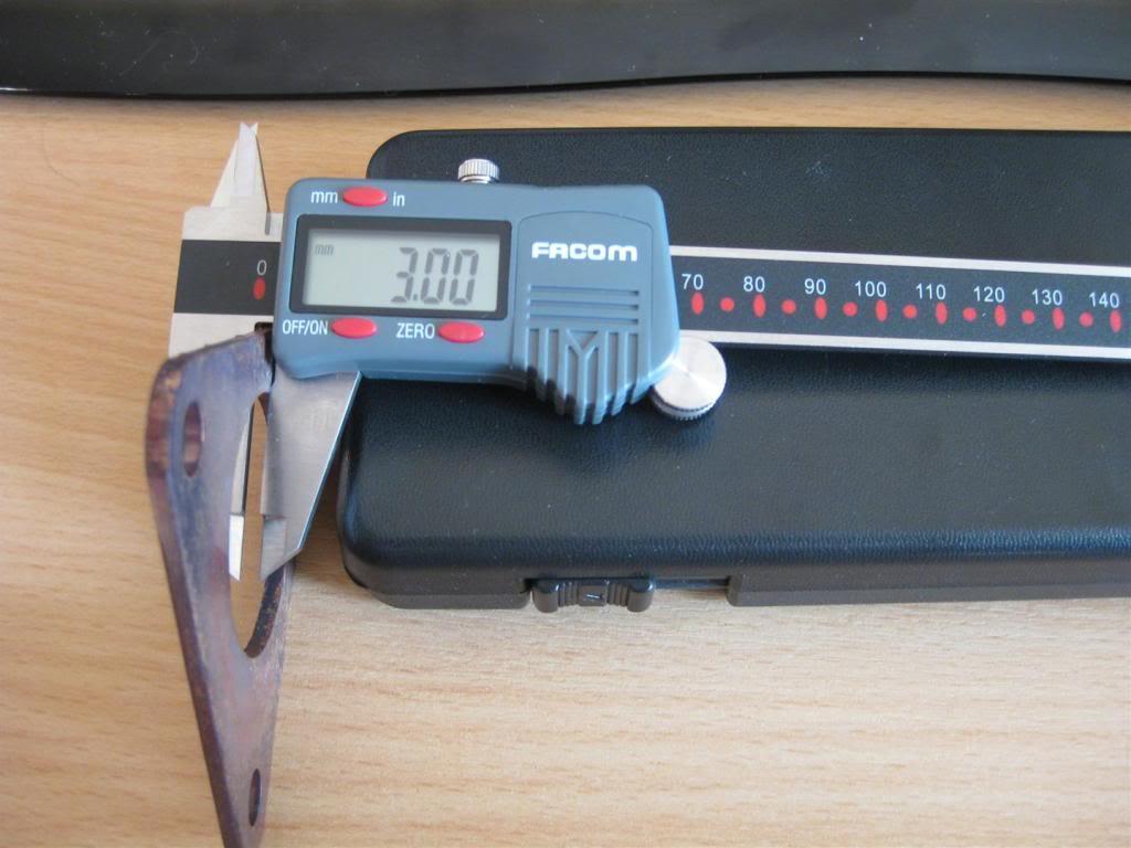

    It also has a constant leak at the turbo housing that whistles under boost and soots up the engine bay
    JC
    The cure for this issue on a 2.4 Puma (Transit Engine) is an annealed copper gasket. I got one from a company called Nakatanenga in Germany.
    Hochleistungsdichtung Krümmer / Turbolader - Artikeldetailansicht - Nakatanenga 4x4-Equipment für Land Rover & Outdoor
    Brian.

    JC, is it the Turbo Flange that is warped? If so then all you really could do if it was seriously warped is to have both the Turbo and Exhaust manifold machined flat. Chances are that both faces are warped and a new Turbo would still leak if an OEM gasket was used. The gasket I have linked too is 3mm thick and should seal all but the worst warping.
    Brian.
