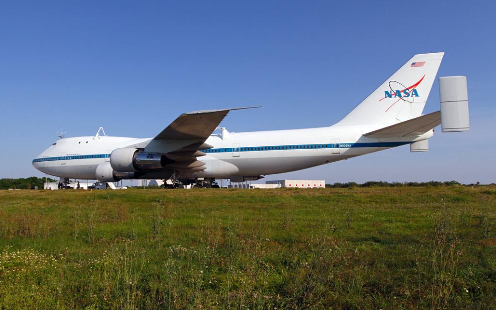

    what are the extra tail fins/planes for?
    and have all transported shuttles worn that Bugatti bum?
    The rear cover on the shuttle is there as protection the engines are removed before the ferry flight. ( it was for this flight so NASA say )
    The 747 is one of two that NASA have used over the years the other was retired last year this one will follow once all the shuttles are relocated to new homes, the extended tail fins help to stabalise the aircraft in flight.

    The position of the shuttle disturbs the airflow over and around the tail of the 747, the added winglets give the stability a back.
    The shroud over the shuttle engines does a couple of things, it protects the shuttle engine exhaust cones and it cleans up the airflow reducing turbulance around the 747 tail.
