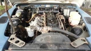

    The engine bay is fairly tidy and clean as in this image.
    I have replaced the bonnet and doors while getting them resprayed Shire Blue its original colour.
    My interest in the gas system is more about running a more efficient cleaner engine as I am a environmental professional and it seemed a tad hypocritical driving the isuzu 120. The turbo is another can of worms at this point and to be honest the amount of torque the motor has compared to the 130 Tdi I had is almost ample for my needs, in fact since I have had it I have incured several speeding fines. After 12 years in the Tdi I have just not gotten used to my new Landy breaking the speed limit. I have a VNT turbo to put on and there is a thread here that deals with fitting this to an isuzu but there are some modifications required to deal with the boost compensator that I have not the time to deal with. But I think first I would like to guage the increase in power without a turbo and if it meets my needs then I will leave it alone or take the next step to turbo the motor.
