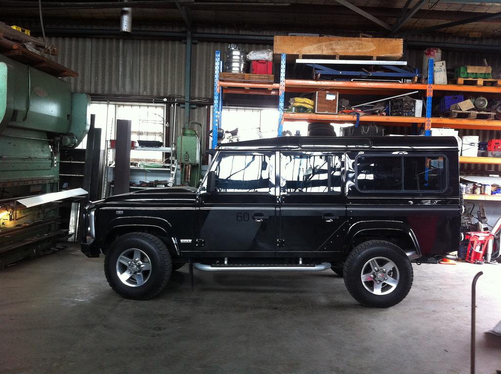

    Hi All , Just wanted to know which was the best brand 2” lift kit available for the Defender without compromising the stand ride comfort .
    I don’t want to have modded beast, just want a little extra clearance for the 265 tyres and a more level look .
    My 110 has a front bar plus I will be adding a winch , as you can see in the pic it sits already very low in the front ,I’m sure after adding the winch it will sag even more .
    I called ARB today for coil pricing, seem ok $225 for both front and the same again for the rear .
    This will give me a 2” lift with 100kg front upgrade for winch and bar and 300kg for the rear or the hard option for the rear which is 500kg .

    Ok so I can go for Polly Air in the rear as it looks like a logical option and also gives you control of the rear end.
    I then just need to sort the front , So It just needs to be picked up by about 1” will the HD LR springs that Tombie suggested sort this out ?
    Or can i just spin up a 1" Acetal spacer on the lathe for the front ?
