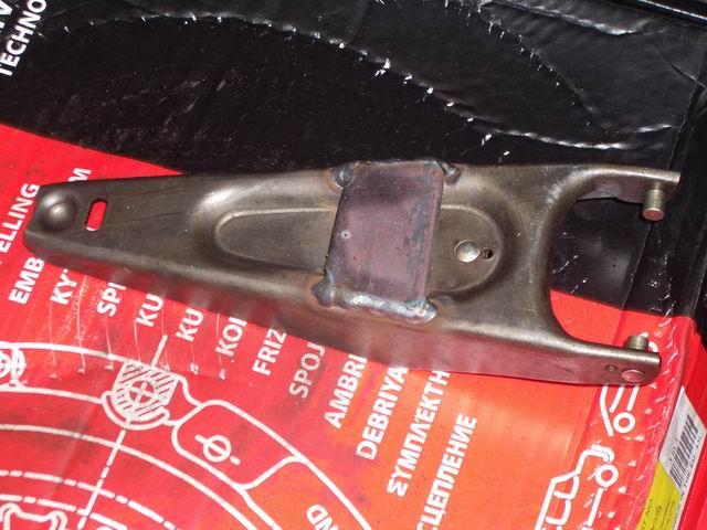

					Some where some time ago I saw in a post a picture of a modification to the R380 GB Clutch Fork, it had an extra bit welded on to it I think to strengthen it.
 Can some one direct me to the post please.

					Peter, I don't have a pic handy, but you weld a strap across the back of the pivot point.
 It stops the pivot fatigue cracking and punching through the fork.

					Here you go
 As with a lot of LR things - the V8 fork design is subtly different and so far no one has ( afaik) posted that it's possible or what mods have to be made. However, note that adding that bit of metal across the back of the tdi fork makes it a never-worry-about-it-again part. It was not that there was too much wear, but too much flexing ( think like cracks in wings). If the people who sell you a new one can't do the mod,  it's just welded over the center of the pivot hole on the reverse.

					Here's one I did a couple of years ago.  It's not as neat as Langy's but it's in there doing the job.
 Attachment 51015
