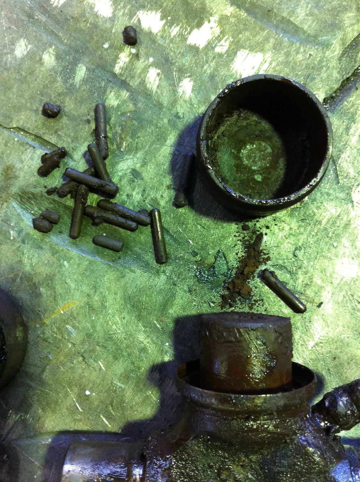

    So after I had the recall done on the handbrake,thanks again to JC sugestions. things are much quieter now. I noticed a squeaking sound in the rear. I had my suspicions that the uni’s were toast. Yesterday I went out and bought a full set for front and rear and replaced the whole set. Even thought I had previously pumped tones of grease in to them it doesn’t seem to reach all the uni’s, this pic is from the rear shaft dif end.

    There are two different spec uni's available, standard 1300 Series uni's that most everyone stocks and HD ones that are fitted by Land Rover.
    Externally they are identical, but here's the differences http://www.aulro.com/afvb/1760247-post299.html
    Yep I bought part # Rear TVC100010-A H/Duty and Fronts were TVC500010-A both with greaser , which were the same as the ones I removed.
