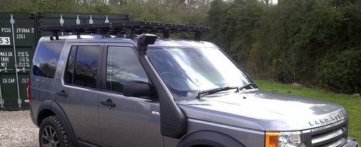

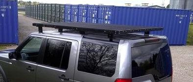

    I have looked at pretty much everything else on the market, and spoken to owners about their racks. The Dolium rack is probably the quietest of the aftermarket racks, and undoubtedly the most practical. Rhino have a flat rack option now ( optional side rails ) but the owners I have spoken to, don't find it particularly quiet. The Hannibal rack looks good, but I have been unable find one fitted for opinion. ( in W.A. ) They are probably the most expensive, even costlier than the LR factory expedition rack.
    Not so, and this is nothing against dolium, these rack run east to west,< Hannibal and Patriot run North to South, so there is alot less wind noise. I have seen alot of people needing to fit a wind deflector with the Dolium racks. However doluim are a cheaper rack and very good...

    As previously stated, I have not been able to compare to a Hannibal rack, and the cost was more than the OE Expedition. Ditto for the Patriot rack, although they may be cheaper ( no idea if they are available over here ) . The Dolium racks come std with a wind deflector.
