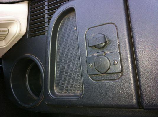

    Bangor, NSW
    1,508
    Here's a photo of where I put mine, as explained in post # 5.
