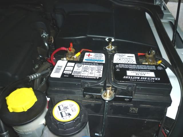

    I have a 70 ah Federal AGM in front of the cranking battery. Just fits. I don't think you would get anything larger in without moving things around.

    The bigest that will fit is the Varta 80ampH will just fit with some trimming of the battery box and battery.
