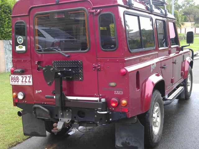

    Never posted a pic before! First time for everything. Hopefully this should illustrate that the pintle can't go where it should go with the wheel staying where it is! I have considered moving the wheel to the trailer but its not an ideal solution. One of the great things about the pintle connection is how quick it is to hook up and having to move the wheel detracts from this somewhat!

    Theres a drop plate adaptor for this issue...
    Jul 2010
    59
    @juddy you mean like this pic from the web?
    It seems this might have some disadvantages including:
    - lower pintle point so trailer draw bar not level
    - security? Looks like plate with pintle hook would detach with one pin so couldn't be left on
    - reduced departure angle?
    This doesn't seem much different from a hayman Reece type set up? I was thinking it would be good if there was a wheel carrier that opened with the door and can be opened from inside and could hold the wheel up and out of the way...

    Just what you want, Rijidij swing away wheel carriers swing with the door and don't have any extra locking when the door is closed, so egress by the far back seat passengers won't be inhibited. The carrier also raises the spare a bit, at least relative to the door mount on my 110. So that might solve all your problems in one fell swoop.

    Quote Originally Posted by isuzutoo-eh View Post
    The Rijidij looked like it would be too low and had some sort of handle on the outside, but I may be wrong? I was looking at this pic on the Rijidiji website:
    Near Seven Hills, Sydney
    4,342
    The handle is to unlock it from the fully open position, so it may be a little harder to close the door but easy to get out from inside.
    I have a poor-man's pintle that has a vertical pin through two holes, with the original spare wheel holder i couldn't remove the pin, with the Rijidij carrier I can remove the pin. Not sure how much difference but there is some!
    Jul 2010
    59
    Thanks isuzutoo-eh. Good to know about the handle. But I'm still unsure about the Rijidij fitting with a pintle hook if the pintle is bolted into the four holes designed for said purpose. This photo looks like the Rijidij carrier has something bolted into the top two holes?
    http://http://rijidijoffroad.bounce.com.au/communities/3/004/008/944/023/images/4567146148.jpg
    Wouldn't the horizontal bar prevent the pintle jaws opening in any event? I can't visualise what you are describing re "poor-man's pintle". Do you mean one that doesn't rotate? If so wouldn't it have the same trouble? perhaps yours is bolted lower down?
