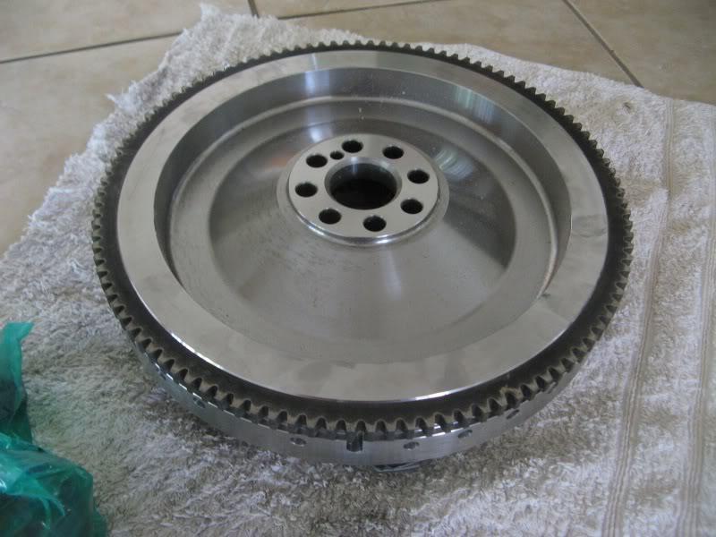

    Yes, I have one, but NOT from Britpart.....
    Get one from Rakeway Motorsport instead.
    Flywheel & Clutch Kits
    I have one in my Defender, and have fitted one in a 2003 D2A aswell.
    The increase is definetely there but its not that bad. If you idle it and depress and release the clutch you can definetely tell there is an extra rattle, but when its driving along I cannot hear or feel it atall.

    Hi Nino,
    In all honesty, if you dont use the car hard, there is probably very little advantage, other than the fact that they are a bit more simple. It was worth it for me due to the not so easy time my car has.
    The dual mass ones seem fine really, and appear to last 7-10 years.
    When mine failed, the actual failure was the thrust bearing, which is plastic, melting.
    The solid flywheel conversion comes with an aluminium thrust bearing instead.
    Experience with previous parts from them has stopped me using anything from them on my cars.
    Its not something I would want to change twice. There are still things that could be done badly, even though as you say its only a lump of steel.
    Accurate balancing would be the main one.
    There isn't much in in terms of pricing between the kits either, although postage from Rakeway would probably be more. Probably worth checking if you did deceide to do it.
    If your gearbox is a bit tired, I believe the noise can be worse.
