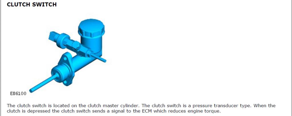

    It is mounted onto the Clutch master cylinder. The electrical plug to the left of the below picture.

    Why they did not have it operated off the pedal is beyond me bet those masters are not cheap with a switch in it

    Anyone (like me) who considers this to be a problem should have a quick read here: Defender2 - View topic - Clutch switch and throttle responce. Basically the switches on the Td5 and the Tdci are opposite from each other. The Td5 one is "normally closed" and to disable it you simply unplug it. On the Tdci the switch is "normally open" and to disable it you need to short circuit it. This is as I understand it from the things I'm reading - I haven't tried anything yet.

    So you don't damage the drive train/gearbox/clutch with quick gear changes whilst the engine is under a heavy load, for example when towing 3.5 tons up a hill?
