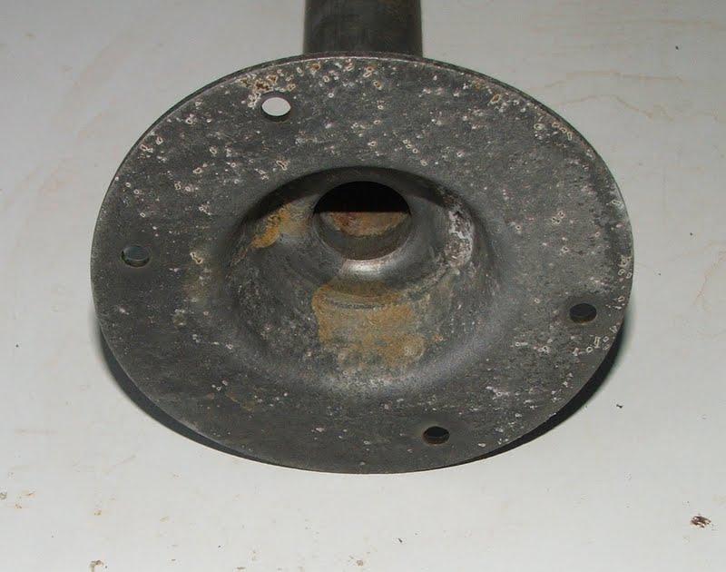

    Slowly stripping for cleanup.
    Before and after soaking for a few days in molasses and water.

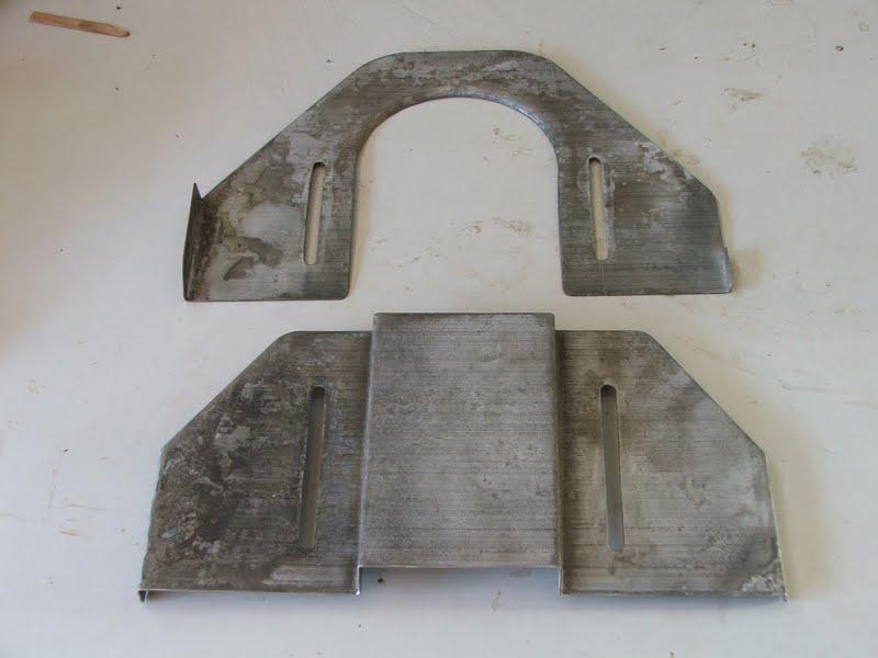

    The aluminium blade guard was scraped and wire-brushed, not put in molasses.

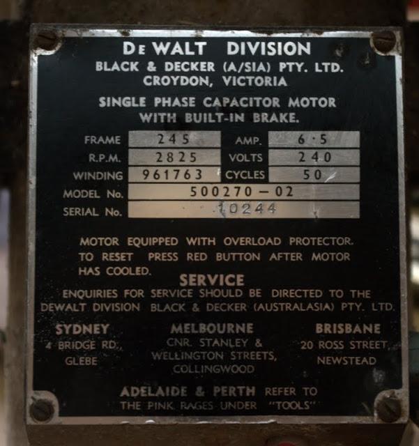

    In the days when B&D made professional stuff it was worth buying... looks like you might have gotten yourself a "keeper" Ron as it wan't "new" when you bought it ...previous threads notwithstanding
    PS: gotta lurve the reference to the "pink pages" on the manuf plate!

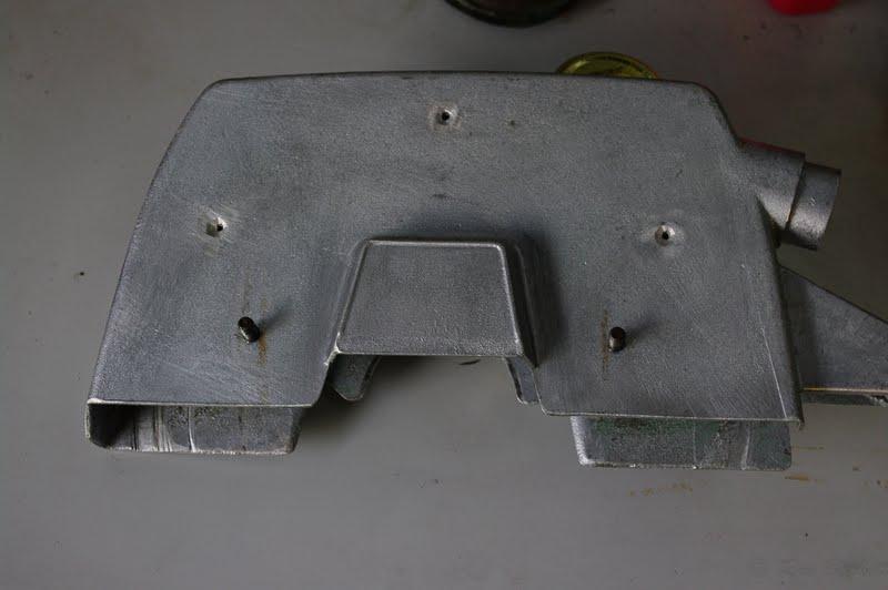

    A couple of the blade guard extensions before and after molasses treatment:

    Yes, thank goodness it wasn't new! And I did the see the Pink Pages ref.

    Doing up old machinery is a bit of a cool hobby I'd like to take up when my sheds right. Actually spotted a very old pump motor out in a paddock yesterday which I'm debating as to whether I might try and obtain.
    But I have a quickie for you, what's with the Molasses/water treatment?
    Cheers Chops
    30,704
    Quote Originally Posted by Chops View Post
    G'day Ron,,
    Cheers Chops
    Do it, Chops. I have an old Advance lathe for restoration, too. It was made in the Fifties in Kilsyth. I use it but I should really should strip it down and repaint it.
    Re molasses, see Getting Rid of Rust
