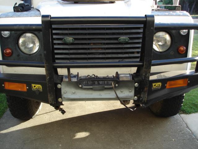

    mine is a thomas.......9000 i think
    you can see the crank handle thing poking out under the cradle.........i must get around to making a crank handle
