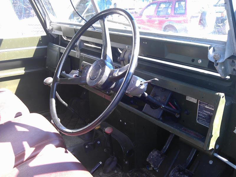

Here's a few more photos. Thanks for reading

looks great. most of the parts are quite easy to get and replace, no special tools required.
Oh what terrific looking little DaOotLove the colour.
Most what you have said is relatively easy with no special tools
Ohh car hoists come in very handy
Looking forward to the restoration/build/learning experience
Mrs hh
Series Landy Rescue
Our FB Page..
That is a GREAT looking vehicle.
All the best with the repairs - have a crack at them yourself, none are too hard, but there is a bit of work if you do the rear main seal.
Remember to post heaps of pics.
Cheers - Gav.
The rear main seal is probably the worst of it, but you should be able to do everything ... if in doubt, there is plenty of knowledgable people here who can give you tips along the way

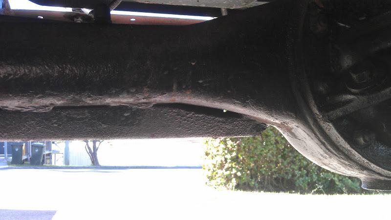

I got under DaOot to clean up some surface rust & flaky paint on the chassis & noticed a couple of things I'd like to ask about.

I also noticed there is reinforcing on the axles front & back.
Is this something that's been added later or did they come from the factory like this?
