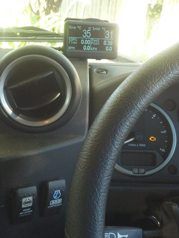

    I mounted mine on the RHS of the steering wheel using the stalk that was an option when I bought it (serious S bend in it to fit the short distance to the windscreen!). Your plan sounds a good option if the clear plastic's angle isn't too severe.
    There are 3 options with the plug -
    1. Loosen the screw that holds it in place so that it recesses by itself with the cover is pushed back.
    2. Leave the cover off (my current setup)
    3. Cut a opening for the top of the plug. I'm sourcing a second cover so that I can go for this option and replace everything to original for services.

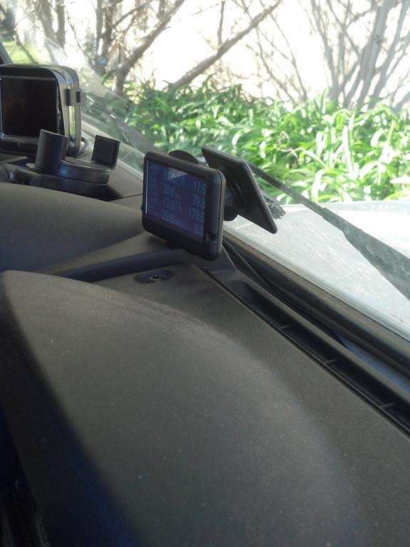

    1. cover off - leave plugged in all the time.
    2. Stuck on windscreen really low
    lead wedged between screen and dash
    runs down side of dash
