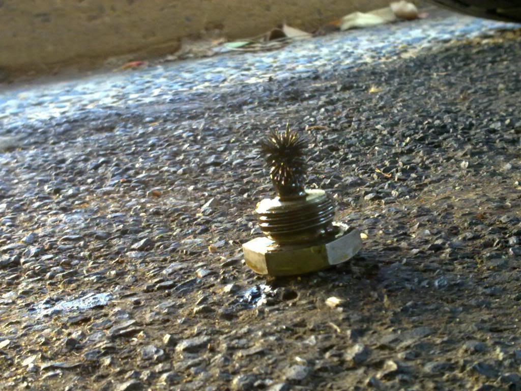

I drained the oil as soon as the problem became apparent, it was clean with no bits & no more fuzz on the magnetic plug than usual, so put the same oil back in with about 20% moreys oil stabiliser. (I'd only replaced the syntrans 1000km earlier)
