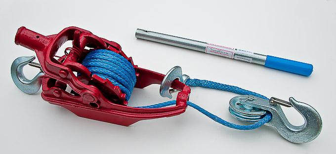

    However I have seen a much better idea with the Power Puller by Wyeth-Scott Co. It is much lighter, smaller, and will handle more weight.
    I will get one eventually, but I can't justify the cost while I still have the Tirfor.
