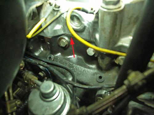

    Arrow points to the position of the oil leak.
    The glossy surface on the block is the oil seeping down the block.

    Well 130camper
    If the oil is indeed coming from that location it is coming from the pushrod/rocker/roller gallery and can only exit there via the head gasket.
    I wonder though, you say the picture shows a glossy oil slick - unless your engine oil is not black (unlikely) could the oil actually be dieso coming from the spill rail between 2&3 and dripping to your pointed location?
    Dieso feels and looks oily but is obviously clear. Engine oil leaking from that location should really be black on a 300tdi.
    If it is indeed coming from the pushrod gallery via the head gasket I would first be trying some good quality sealant externally after obviously cleaning the area well. There is no actual oil pressure in the pushrod galleries and you are only containing blow by pressure. I certainly wouldnt be cracking the HG to fix that sorta leak on any landy that graced my driveway!
    If it is dieso from the spill rail then just buy enough fuel spill line from your friendly dieso specialist and replace all the spill lines.
