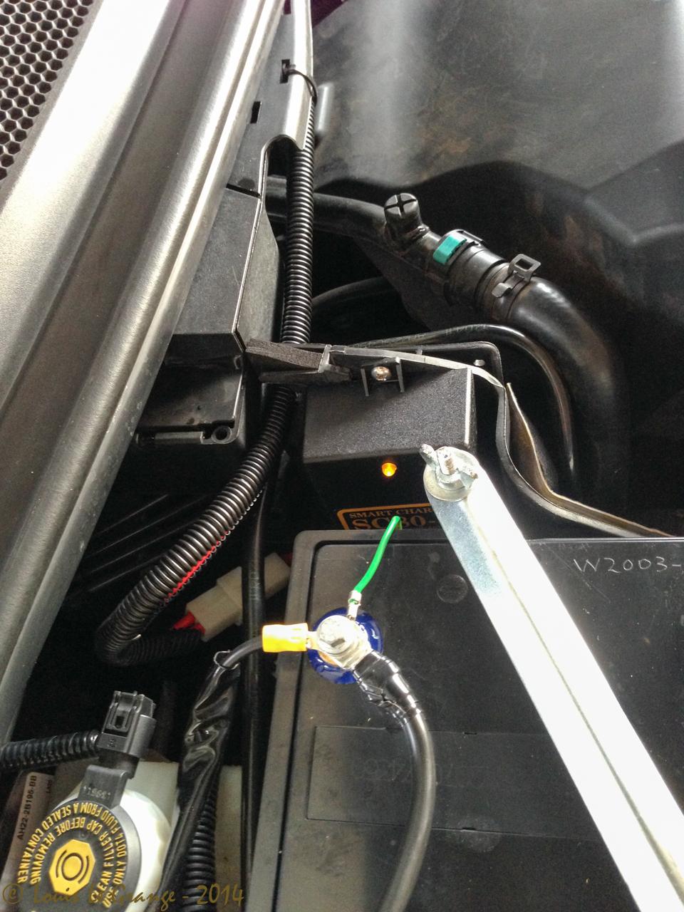

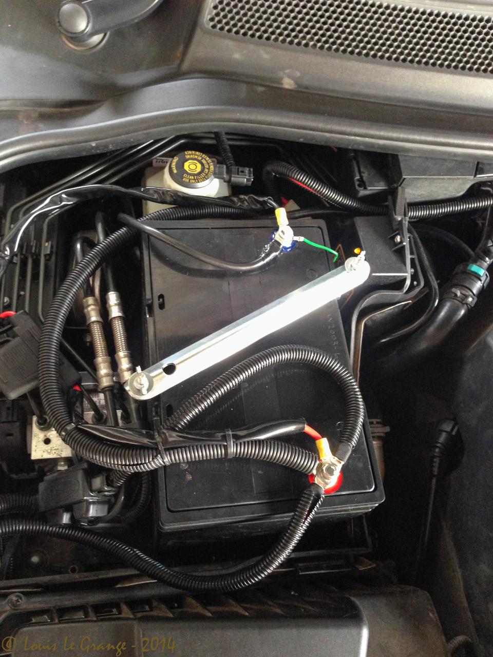

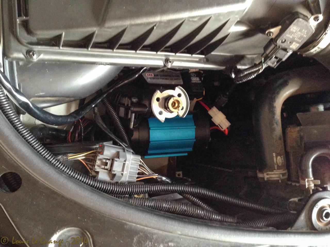

    It took them a bit more than a day to install the system, add 3 new outlets in the back, reroute my Brad Harrison trailer cable from the main battery to the new 2nd battery and they also installed an ARB compressor behind the headlight for me.
    I can honestly say that it is a top notch install and I would like to believe its the biggest(70AH) 2nd battery ever fitted in a V8 D4.
    Need to still fit a battery monitor to check the 2nd battery and will test the system properly on our Rhodes trip next week.
