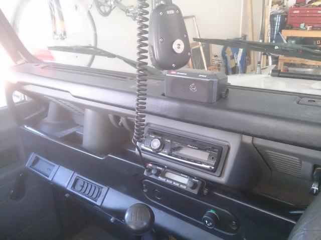

    UHF Fitted.
    Uhf fitted.
    Picked up power from the cigarette lighter and the main unit is in behind the roof liner. Aerial is through the rood with a tiny 1/4 wave aerial which seems to be best around the hills. External speaker sitting in the hole where the ash tray was. Rather neat!
    Vhf Lead sits in the dash to the right of the radio to plug in the receiver when it is in the car, I can use the VHF aerial on the bull bar.
