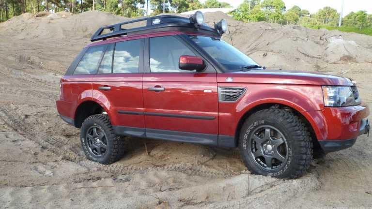

    Went for these Hankooks....
    Really happy with them.
    Cheers, Craig
    2,248
    275/65R18 is the only size mud tyre that will fit, albeit with a few modifications. Maxxis Bighorn in that size is brilliant off-road, but less than competent on bitumen, especially when wet.
    Gordon
    Apr 2012
    791
    Quote Originally Posted by gghaggis View Post
    Gordon
    Such a top looking rig!
