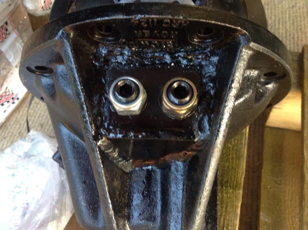

    Well look what DHL just delivered...
    A new Ashcroft full bolt in front diff complete with HD gears, air-locker & pegged.
    It's the final piece of my Ashcroft upgrade
    Spanners to turn.......
    Diff pegging.(from the out side)

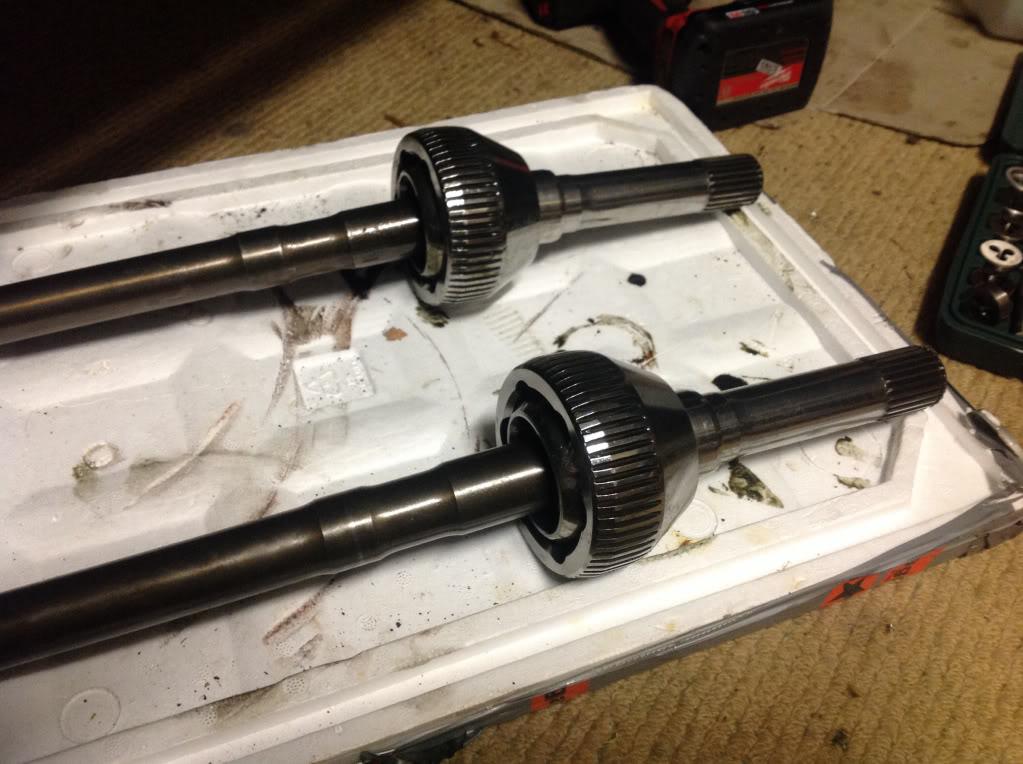

    Install half way there.
    Centre in, air line connected, diff guard on and prop shaft connected. Just waiting on new wheel bearings, oil seals and lock nuts.
    After 30,000k's the Ashcroft CV's and 1/2 shafts look like new. No burr's inside the CV's & not a twist or blemish to be seen on the 1/2 shafts.
