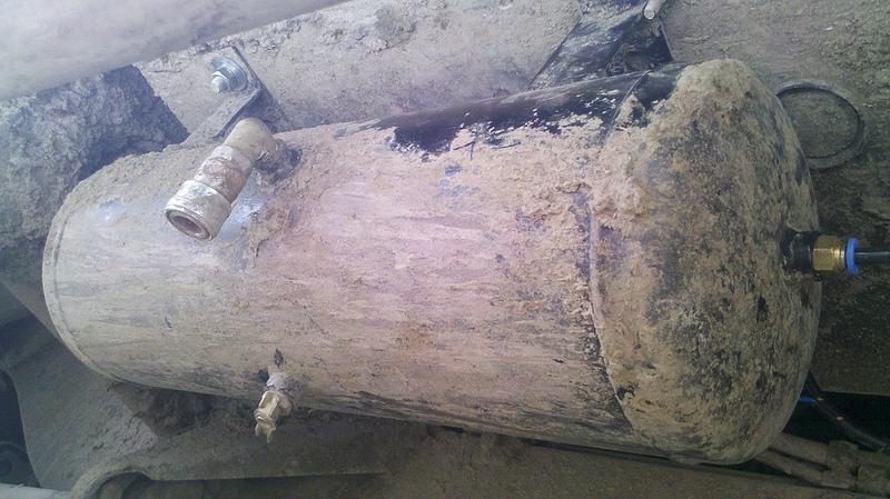

    Hello and welcome! I don't know if this helps but on my 90, my tank is between the body and the chassis rail behind the the drivers seat.
    2013-01-12_14-08-44_141 by James.Elphick, on Flickr
    I have now moved my Nitto connector inside as they don't tolerate road dirt at all well. The tank also feeds the diff-lock solenoids. More pics on my photo stream if you can find them!
