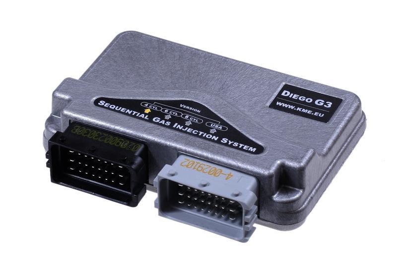

    I think my system is a KME Diago G3 going by their website and pictures so have downloaded their software and purchased a USB lead

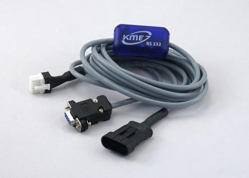

    I have a KME Akme system, the diagnostic lead, and the software.
    This is the same as my lead:
    Yours definitely looks like the G3 (below)

    The lead I got was a cheapo from ebay, just usb. The software I got direct from the KME website. There a two versions for Diego G3, I tried both with similar results.
