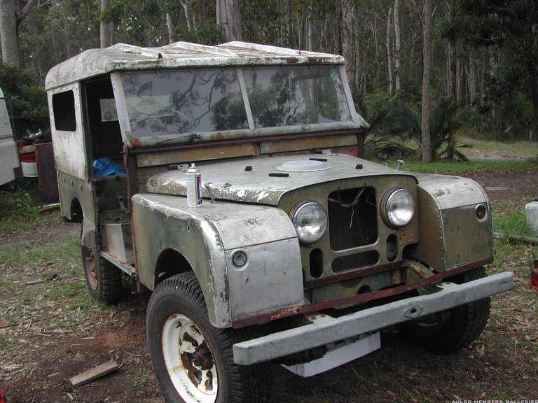

    Fitted the roof yesterday with the help of Allan (VNX 205), see pics, looks good.
    Looks like I'll be needing some information and a few bits <see my wanted ad in the markets>
    What were the devices are used to clamp the front of roof to top of windscreen?
    Anyone know where to get rubbers and glass for side windows in canopy?
    How do I fix leaking fuel tank or is there some method of sealing from inside by putting a substance into tank which will permanently seal it?
    Any help will be appreciated, can contact me by PM, Email, Frank.Stanton@bigpond.com or mob. 0407103320, Thanks, Regards Frank.

    Arthur, your magic mate, where do you get all this info, that's incredible, I can't thank you enough, hope to be able to repay you someday.
    Actually the ball joints are in good nick, it's the drag link tubes that are buggered, one is bent so far that it has squashed flat and kinked, fracturing the metal, the other has broken cleanly off where the ball joint thread stops, so I need to replace or make new ones. I have emailed Jim , I will try ringing him tonight.
    I did a fruitless search on eBay and was starting to worry, the brake lines are the rustiest part of this S I, it surprised me how bad a condition they are in compared to the rest of the car.
    Over the next few weeks I will be pulling the body off and cleaning up the chassis, it's amazing, the paint on the chassis still has its' lustre and only surface rust where it has been exposed to gravel rash, will take more pics as I progress, how do you like my little roof top. I bought this a few years back (not knowing what model it was off) with the intention of using the roof only as a lid for the top of a 109 SIII ute tub which I was going to fit to my army W/shop trailer chassis and use it to build into a camper trailer, good luck, eh, thanks again, Regards Frank.
