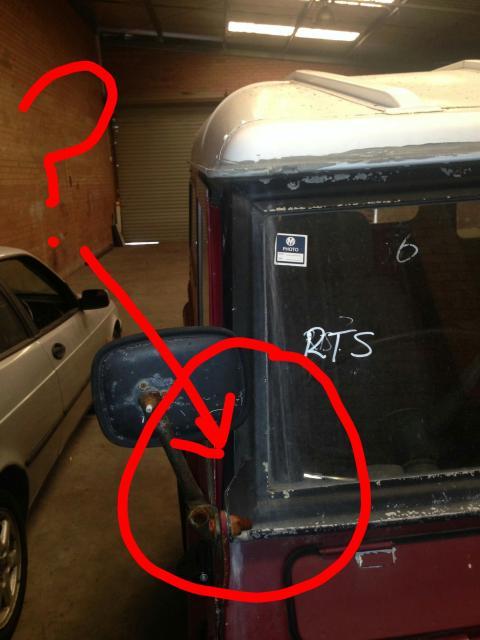

    Old topic but I believe my recent purchase has one judging by the way the screen frame bolts to the mount on the body? I could be wrong though.

    You are wrong. This is not an opening windscreen as discussed. All Series and 90/110 and soft top or early Defender windscreens are attached to the firewall by hinges. This allows the windscreen to be folded flat when the top is removed (about five minutes with the soft top, an hour with the hard top such as you have, albeit with seatbelt issues).
    The basic Landrover design was envisaged as being either open or with a soft top. Hard tops or cabs only came later and were not fitted to most Landrovers until seat belts and vehicle thefts became more common in the 1970s or 80s.
    The discussion in this thread refers to a windscreen that opened withoout removing the hard top - these are very rare and were never a factory option.
