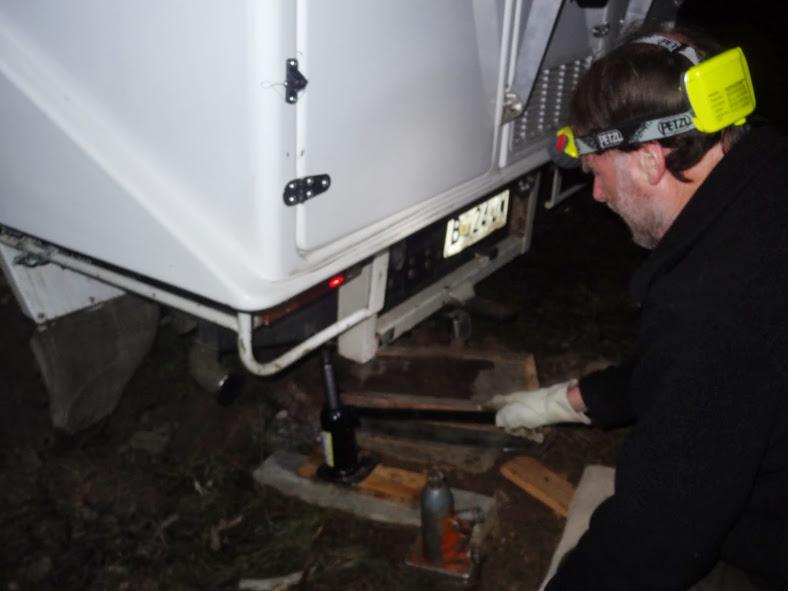

    Hi,
    really could have used one here.
    Got pulled out by a really old Toyota passing by.
    Oh the embarrassment!
