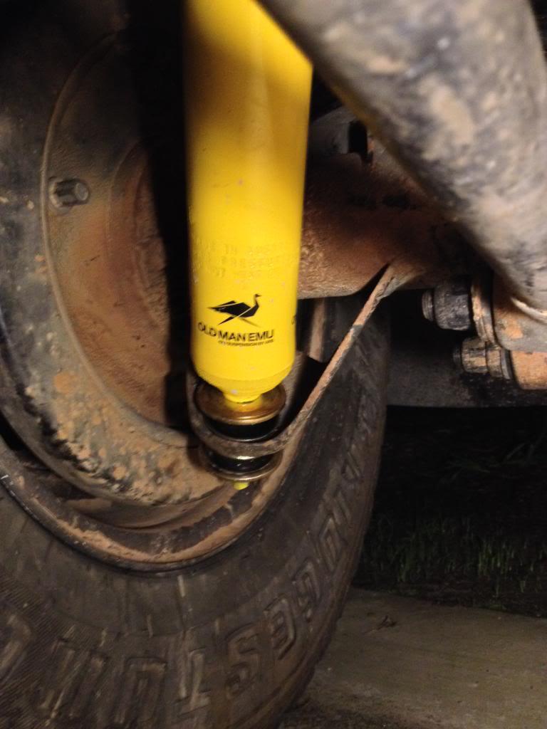

    Had the Old Man Emu shock and spring kit installed on the county a couple of weeks ago. Haven't had a chance to take it off road yet but on-road performance has been great.
    According to the specs, the package only adds a 30mm lift but the original springs and sagged significantly, so the effect is of an even greater ride-height increase.
    Now I'm starting to wonder if cranked trailing arms should be added to the mix. How does everyone feel about the amount of bend being put on the recently replaced trailing arm bushes?

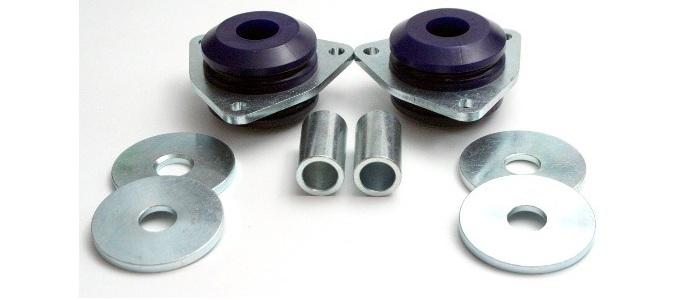

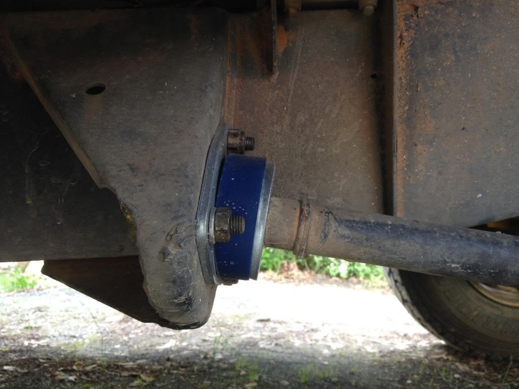

    Those trailing arm to chassis bushes are horrible. What brand are they?
    You need to swap them for these from Super-Pro, which have a groove to allow more flex. This is especially important with a lift.
    http://www.qtservices.co.uk/parts/cu...%29698x300.jpg
    EDIT - also the fitters seem to have left out at least 1 spring washer
    Looks like a Nyloc that usually don`t require spring washers but glasses could do with a polish
    AM
    WA
    13,786
    Quote Originally Posted by Ancient Mariner View Post
    AM
    Good point - I missed that - just saw a spring washer on one but not the other.

    Thanks all. I had to order new trailing arm bushes sight-unseen as it seems nobody in SA keeps them on the shelves. The rubber ones that had been on there were wrecked so replacements were needed ASAP.
    I found the super-pro ones online and even got a price through Burson but ended up going with the ones pictured from BritPart/Sovereign Automotive at Kent Town.
    Oh well, when these ones go squish, I know what to replace them with
    I have heard that rose joints are illegal and a bit more harsh to boot. Not a sensible option in this case. Off-road time is a sadly low proportion of what the County gets used for. Thanks for the suggestion, though
