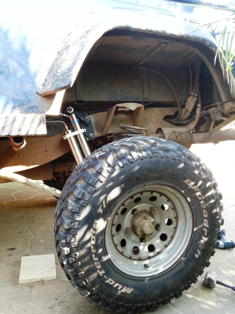

we converted to pins to the lowers and made custom turrets and rear mounts... I will see if I can find a couple of pics
Front turrets were +35mm. Rear mounts are +50mm (for the 12" shocks)
Springs are retained now but this gives you an idea of travel
