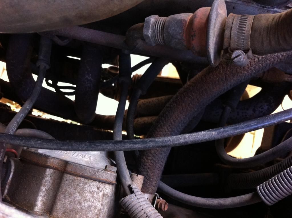

    Have attached a dodgy pic of some of the engine bay bits...

    Although its illegal to work on a LPG system yourself this doesn't stop most home mechanics from doing it anyway. The most important thing to do is to close off the gas tank valve to the pipe to the engine and make sure that you are well clear of any stray ignition sources, eg HWS pilot lights, before you undo any liquid carrying fitting. Any plumbing connected to the tank will contain some liquid under pressure, but the flow should stop completely in 10-20 seconds. Then the container is safe to remove.
    I suggest you remove as many bits of the system as you can including the pipe to the front, all new conversions are supposed to get new pipe in any case. A vehicle that doesn't look like it's been on gas will pass an inspection more easily.

    As Bea-utey says and remove the lpg compliance certification plate from the engine bay a dead giveway.
