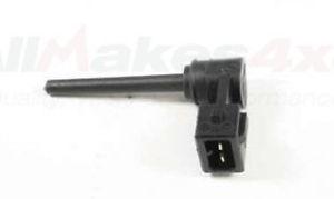

    The car has a warning on the dash at start, low coolant however it is not low and after 600 miles is not loosing coolant. I suspect the sender so was going to buy one and fit as a Thank you to the cars owner.
    I have read conflicting things, sender is part of the tank, but I can find the sender for 6 pounds on e-bay on its own?
    Is this just a quick swap over of the sender. I have access to limited tools and dont want any dramas. Is this a 5 min job?

    Known issue.
    Ball in the sensor becomes porous and sinks.
    New coolant tank is the fix.

    Yep. Just replaced mine a couple of months ago.
    It might just be the sensor, but I found it quicker and easier to just replace the whole bottle.

    Is there a reason its hard to change the sender or is it just that it is a part Land Rover wont sell on its own?
    Sydney, Australia
    2,351
    Sender is not the issue. It is the float in the tank that fails. It is part of the tank.
    It could be the sender but unlikely.
    2,622
    Replace Tank Assembly, Quite an easy fix, couple of 10mm bolts & few hoses, top up with coolant and away.
