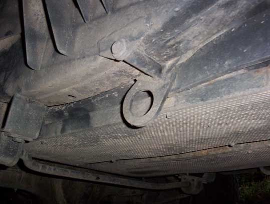

    Mine has a very neat Scuba tank dual system. Scubas tucked up high underneath where the petrol tank was. Nothing to hang down and get banged and knocked.

    The 2 scuba tanks neatly fit underneath the rear. ( there is then a flat mesh bash plate covering the tanks)
    I have nothing hanging below and cabin space is as per original.

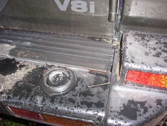

    The filler cap is on top of the bumper on the drivers side next to the spare tyre. So I don't have to bend down all the time to fill.

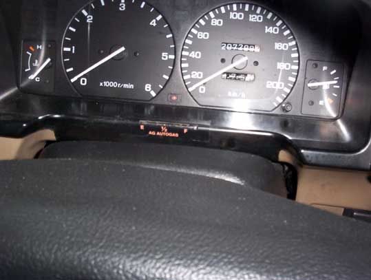

    The Led fuel guage is a strip led light arrangement that is neatly inbedded in the bottom lip of the guage instrument surround. This is a neat and looks almost as if it was part of the car.

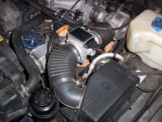

    I have a holden airfilter box with some neat plumbing. And Holden air fillters are cheaper too!
